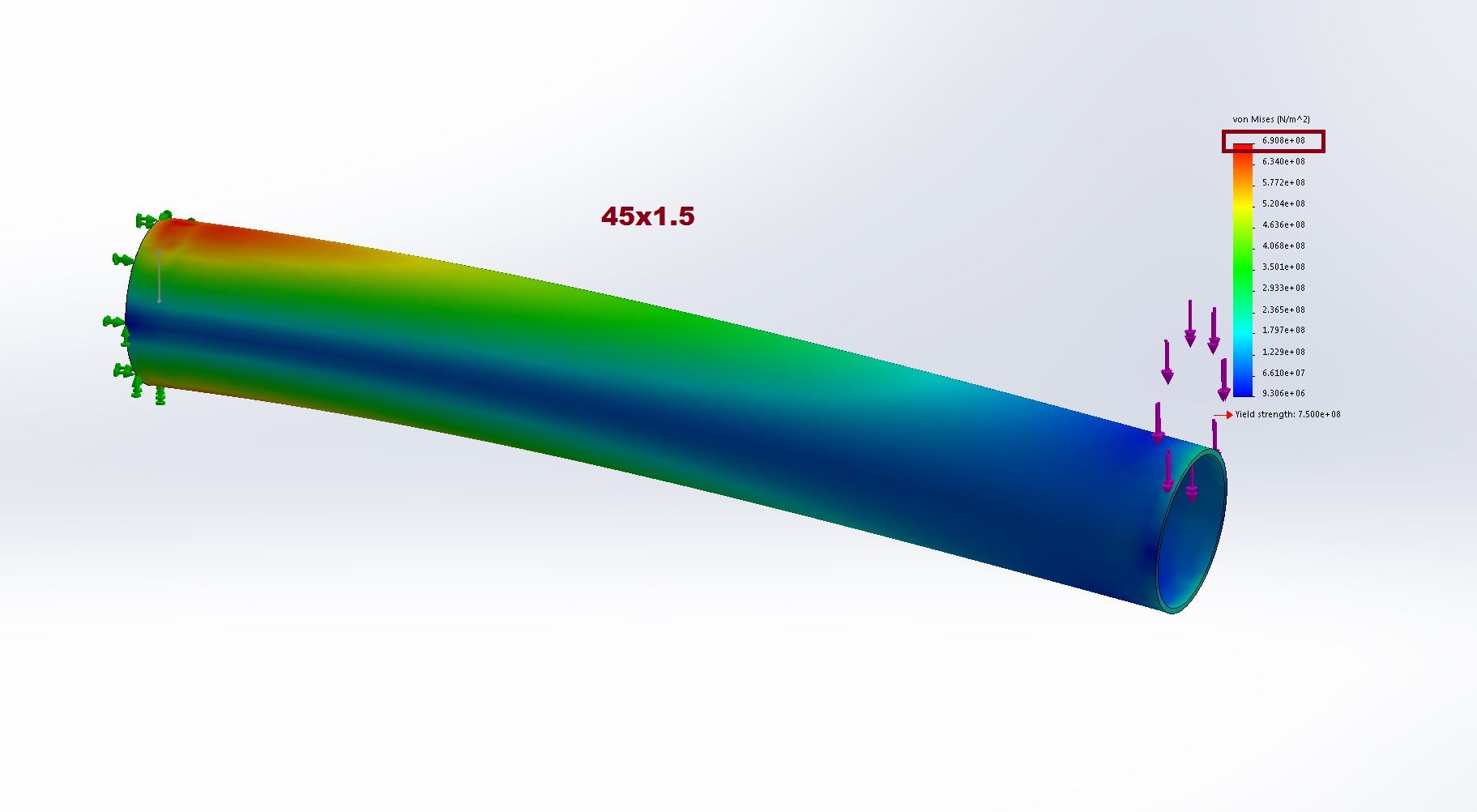

The old frame from 40x1 pipe but lightweight 2.1 kg, has been used by customers in Germany, Russia and Latvia for several years.
The new version will be from tube 45x1.5 but the weight increase to 3.33 kg.
Weight increase by 60%.
But strength increase 1.8 times. I hope this will be enough.
