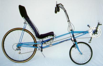

Bad idea with small front wheel in the winter?
Viesti Kirjoittaja oivavoi »
Hello Finnish recumbent friends, hope it is ok that I write a message in English!
I'm a fairly new recumbent biker from Norway. I want to start riding a recumbent bike this winter for my commute, previously I've only used an upright MTB with studded tires.
I've come to this forum since I think this is the recumbent forum with most expertise on using recumbent bikes during winter! I've read much of this thread using google translate.
What I wonder is whether anybody has been successful at riding a recumbent during winter with a small front wheel, with reasonably wide tires? Or is that a very stupid idea? My only recumbent bike at the moment is a Lightning P-38, which I really like. It has a 26 wheel in the back, and a 20 wheel in the front. With a new fork I could fit the 20x2.15 studded tire from Schwalbe in the front. 26 x 1.75 studded tire in the back. Would that be enough, do you think, or do I risk constantly slipping etc? I've also been thinking of getting a high-racer, like the Azub Max, Specbike Xtrim, or possibly a Nazca Gaucho Tour with 2x26 wheels. But I really like the P-38, so I'm tempted to try it - unless it's doomed to fail.
regards from Norway
Viestit: 1272
Re: Talvipyöräily
I had Challenge Hurricane with 20” wheels and I did ride it in winter with Schwalbe studded tyres. It is doable if roads are well plowed. In deep snow you need larger wheels. Nowdays I have Azub Max 26” and I’ve been riding with it few winters already. I’ve been using Continental studdless winter tyres and Suomi Tyres studded off-road tyres. Larger wheels do work better in deep snow.
Check out this winter cycling playlist on my Youtube channel. There’s few videos about Hurricane, lot of videos about Max and few videos about riding a velomobile in winter.
Viestit: 7579
Re: Talvipyöräily
Lightning P-38 may not be the best winterbike, but still quiet good. Rear tyre has lot of weight.
oivavoi
Viestit: 10
Liittynyt: 16 Loka 2020, 01:57
Re: Talvipyöräily
Saukki kirjoitti:
Thanks! I saw your Azub Max video, that was what gave me the idea of getting one... :)
Didn't know you rode a Hurricane before, cool. Will take a look!
I'm living in Oslo, where roads are mostly plowed and salted. So on 90 percent of all winter days I don't have to plow through snow. I'm mostly concerned about the front wheel sliding in high speed, but it might be that it will be fine with a studded tire.
Cool, thanks. Is it bad or good that the rear tire has much weight? Good for traction I guess, but maybe not for grip on the front wheel?
Viestit: 1272
Re: Talvipyöräily
oivavoi kirjoitti:
In my opinion, with a recumbent bike you need to have good traction (studded tyre) on both wheels. With upright bike you can get away if the rear wheel slides, because you can easily use your body to balance the bike. But with recumbent that’s not so easy. So if one of the wheels on your recumbent bike starts to slide, you are going to fall.
Viestit: 7579
Re: Talvipyöräily
oivavoi kirjoitti:
In many cases swb bikes front tyre carry over half of total weight. P-38 looks about 55% rear and 45% front wich is good balance in winter in my opinion.
