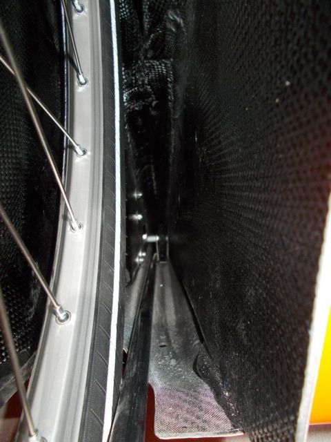

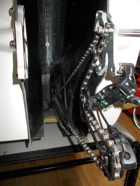

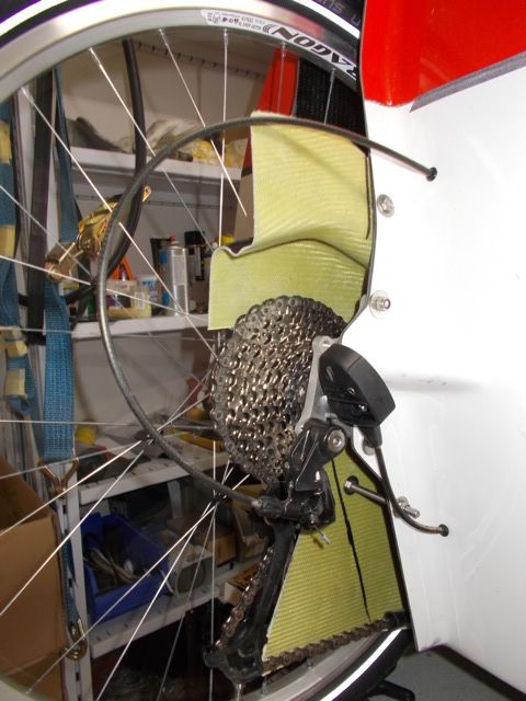

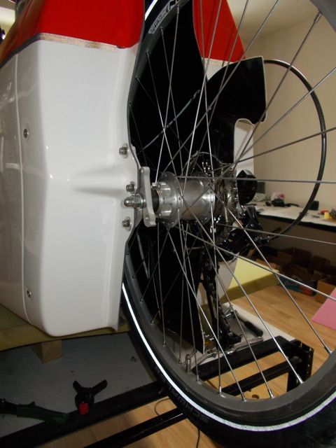

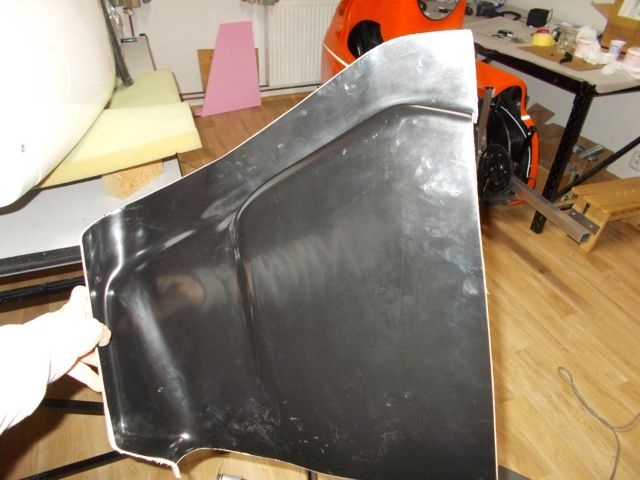

Stephane Bowingin luvalla laitan tänne infoa WAW@2014:sta. Hän antoi erinomaisen vastauksen kun kysyin häneltä sähköpostitse, miten ketju ja rattaat on suojattu WAW@2014:ssa lialta. Tiivistetysti hän kertoo, että suunnitteilla on kotelo, joka erottaa takarenkaan voimansiirrosta. Vastauksissa puhutaan kuvien kääntämisestä 90 astetta. Käänsin ne valmiiksi, jotta arvon lukijä välttää niskajumpan.
Alla häneltä kysymäni kysymykset ja niiden vastaukset:
Q: The rear tire is 100% isolated from the middle module, so tire can't toss dirt and water to the back of the seat when it's spinning?
A: Yes, this is well Isolated and no mud or water goes from the rear wheel to the back of the seat. There is only on the bottom a tunnel of 2 cm x 2 cm trough which the chain goes form the back to the rear. There are 3 holes in the bottom of this tunnel to get rid of water and mud sipping in (this is however not a perfect solution for very muddy and wet roads, see second point). On the pictures taken form the back to the front you see the rear wheel and the tunnel for the chain going to the front of the bike. On picture is without wheel but with chain, the other with chain and without wheel. Turn the pictures 90 degrees clockwise to see them in the normal position.
Q: Are cassette, chain and derailleur 100% isolated from the rear tire that inevitably spreads dirt and water to it's surroundings?
A: Not today. Till now we offered to mount a classical bike mudguard to direct most of the water and mud back outside but it has limited effect and chain and tunnel under gets dirty if the WAW is used on dirty roads. I am working on a solution and can already show you the pictures of the prototype. Two laminated parts that will separate the chain, cassette and derailleur (clean part) form the wheel (dirty part). I have this weekend been mounting the first part which is fixed inside the rear wheel case. The final first part will be shorter then on the pictures. The second part will be removable so that you can easily access all components and still use the possibility to make the WAW compact for transport reasons. Creating this second part is now on the agenda. Time to have all ready for commercialization should be 2 months from now.
