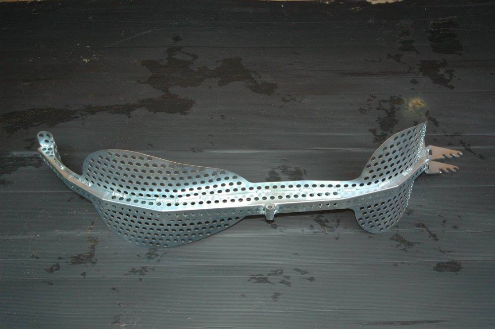

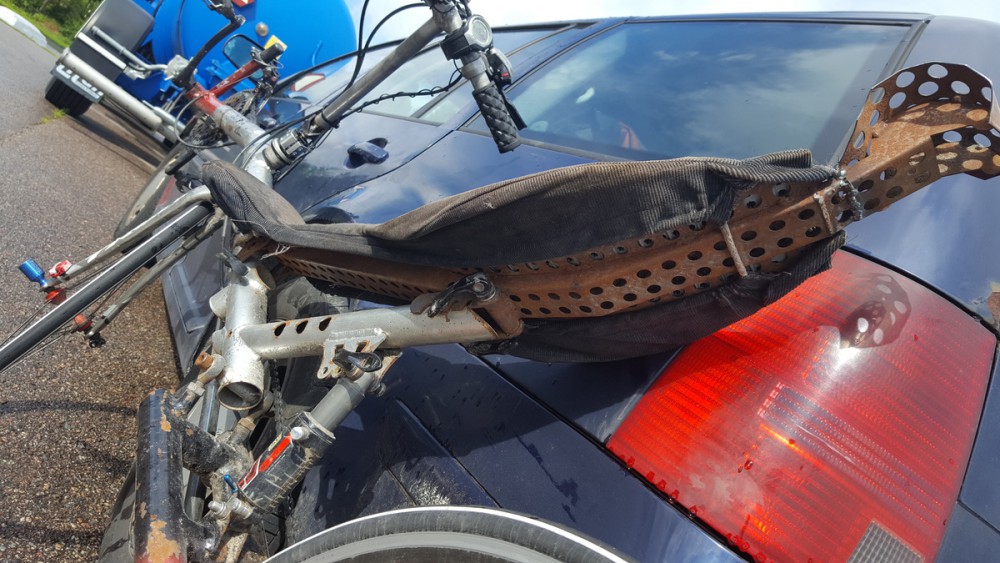

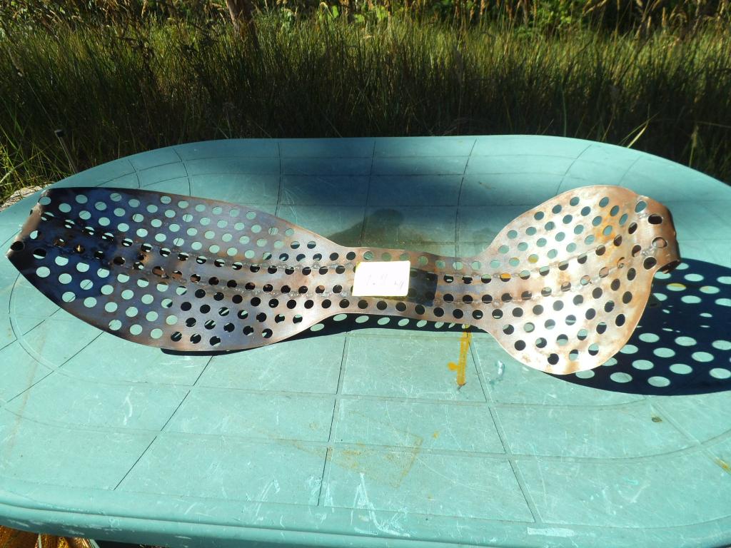

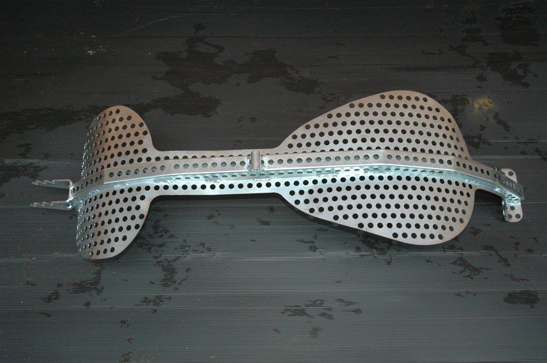

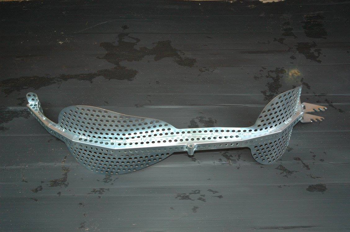

My name is Vladimir, I'm from Latvia, many of you I met at a competition in Nokia. I noticed that many people were interested in my seat. I'm ready to tell more about it.

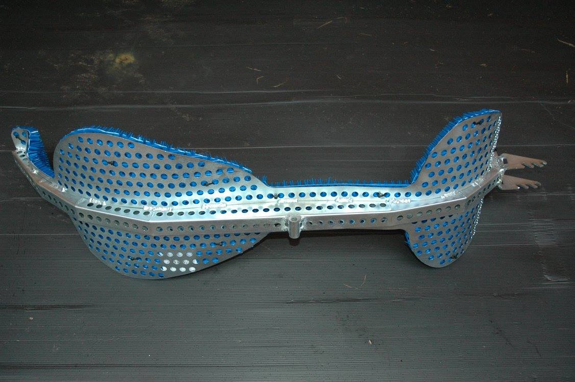

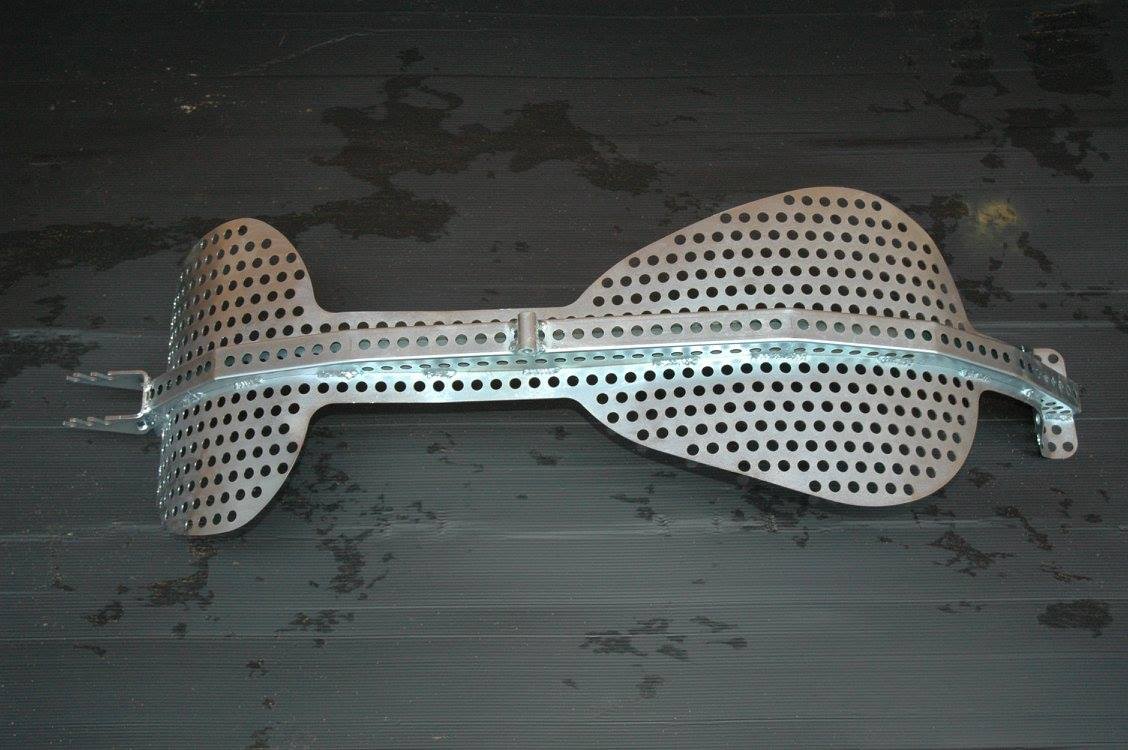

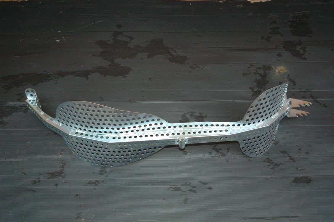

The seat is made in 2013 from ordinary steel 1mm, cut with a laser and welded, everything is simple. Thanks to the minimal form and a lot of holes, the seat is light enough. With brackets 1.9kg.

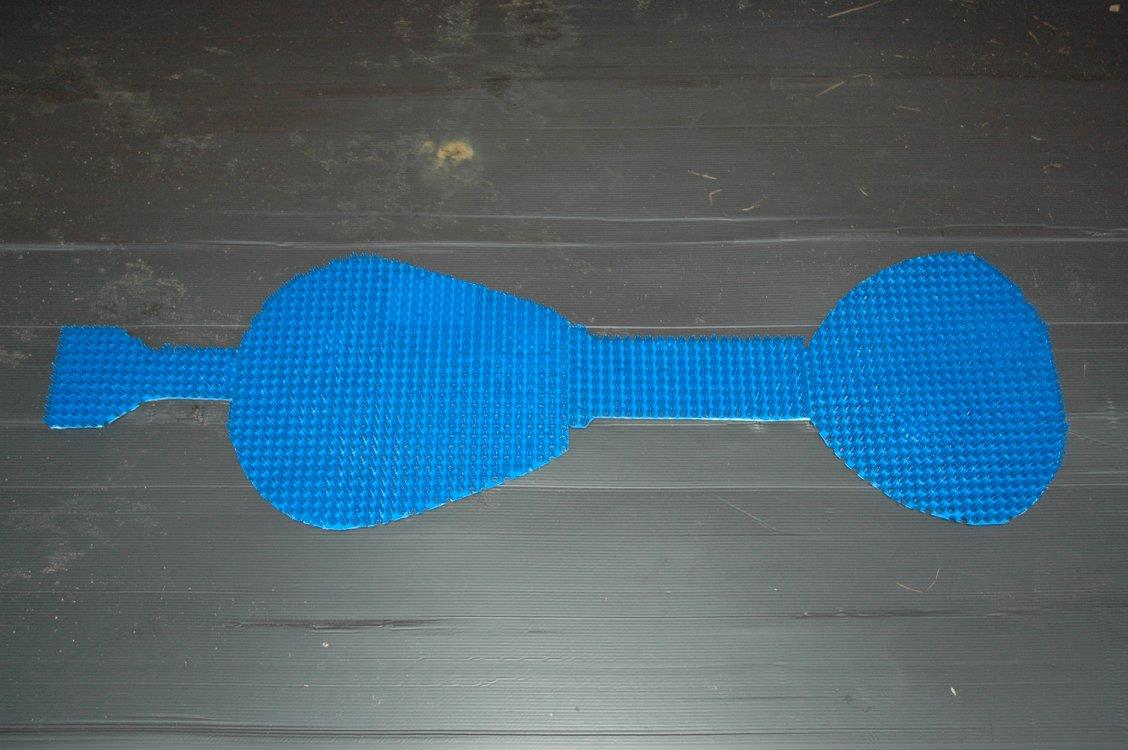

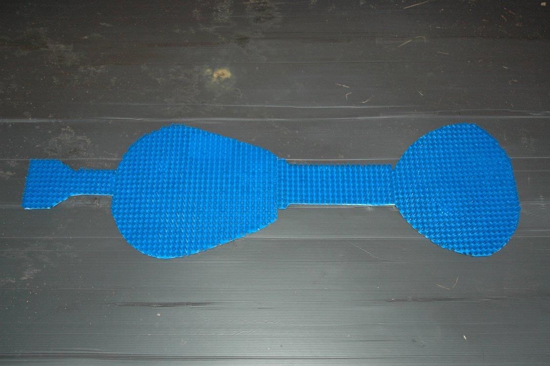

Seat mat also very interesting.
If you will be interested I can give drawings for laser cutting.

Very intresting seat in deed. Laser cutting gives a lot of freedom for designer.
One question i have. Why did you choose steel even if your bike is aluminum? Was it the reason the impossibility to weld aluminum sheet thin enough.
I am intrested to build a integrated seat(able) bike frame, which can use a little boot for tools, spare tires and other necessaritys.
Frame-seat should be thin aluminum sheet which is very difficult to weld. Maybe seams should be riveted. By laser cutted parts it might be possible but can grow too heavy. :roll:

The frame of my bicycle is also made of steel.
With aluminum, there are many problems: strong aluminum does not bend and you have a lot of welding, soft aluminum does not hold loads, thin aluminum is hard to weld and thick has a lot of weight.
As a result: many problems and little benefit.

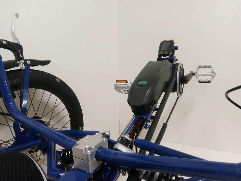

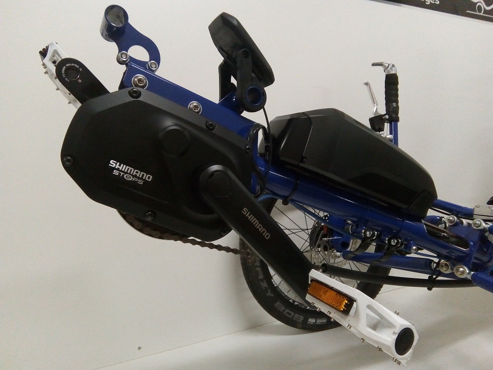

and here it is!
a lot of difficulties with the adaptation of fastening, wires and programming behind and now I can say: the motor works very nicely, guesses your desires and helps smoothly.

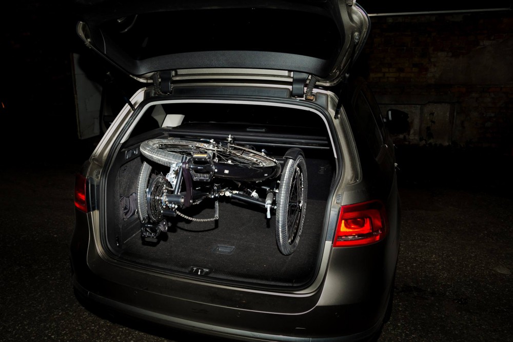

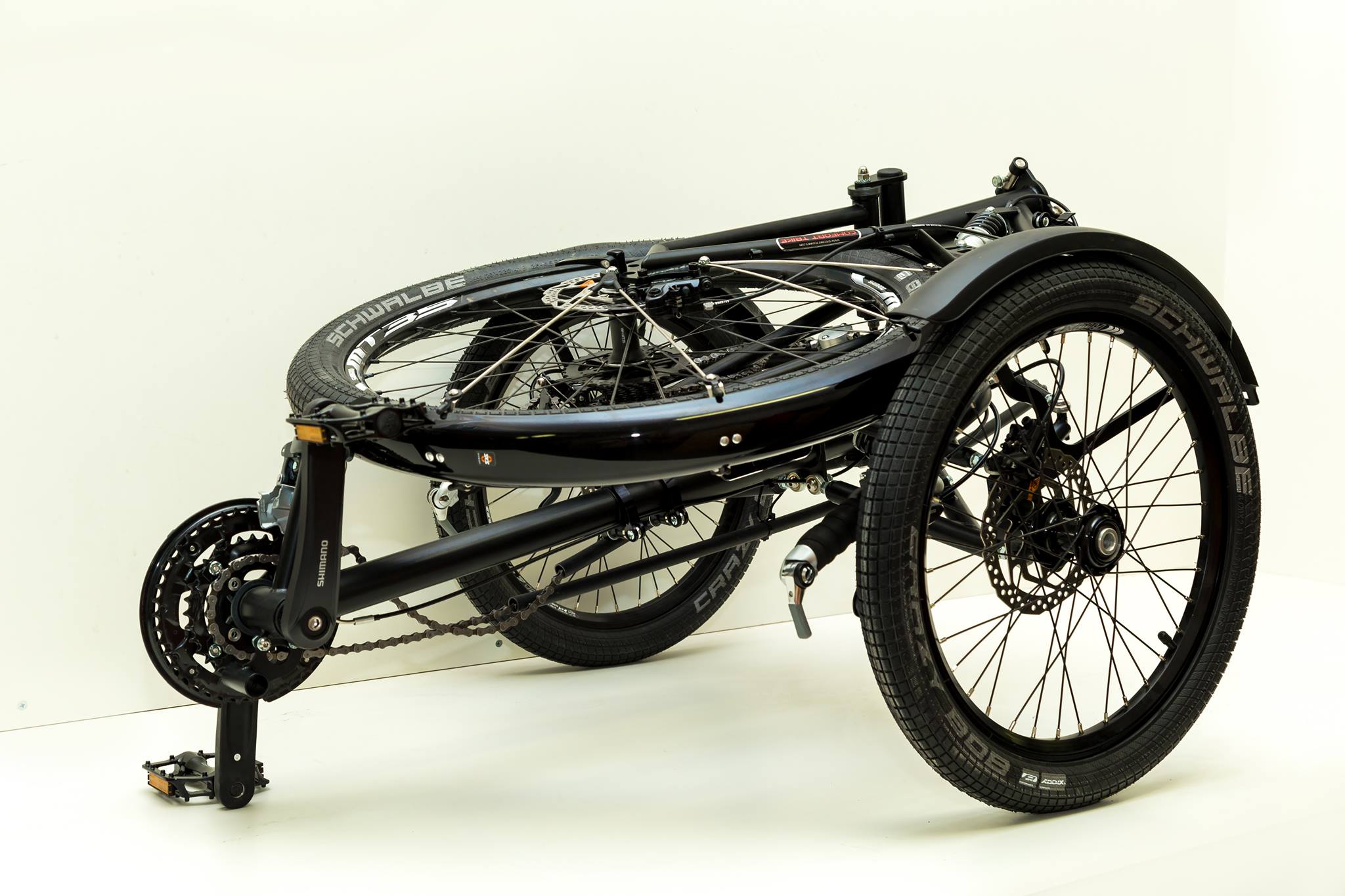

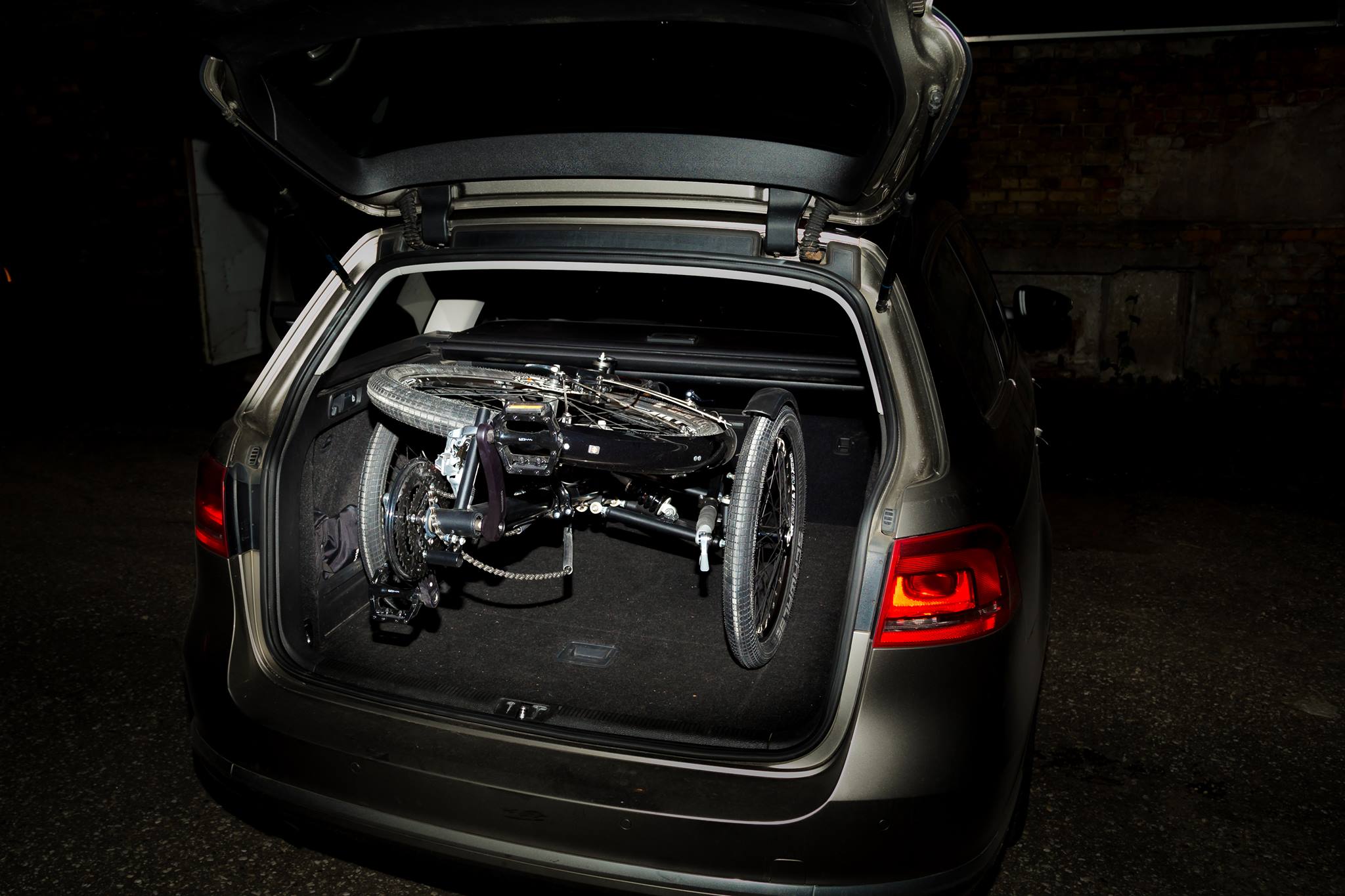

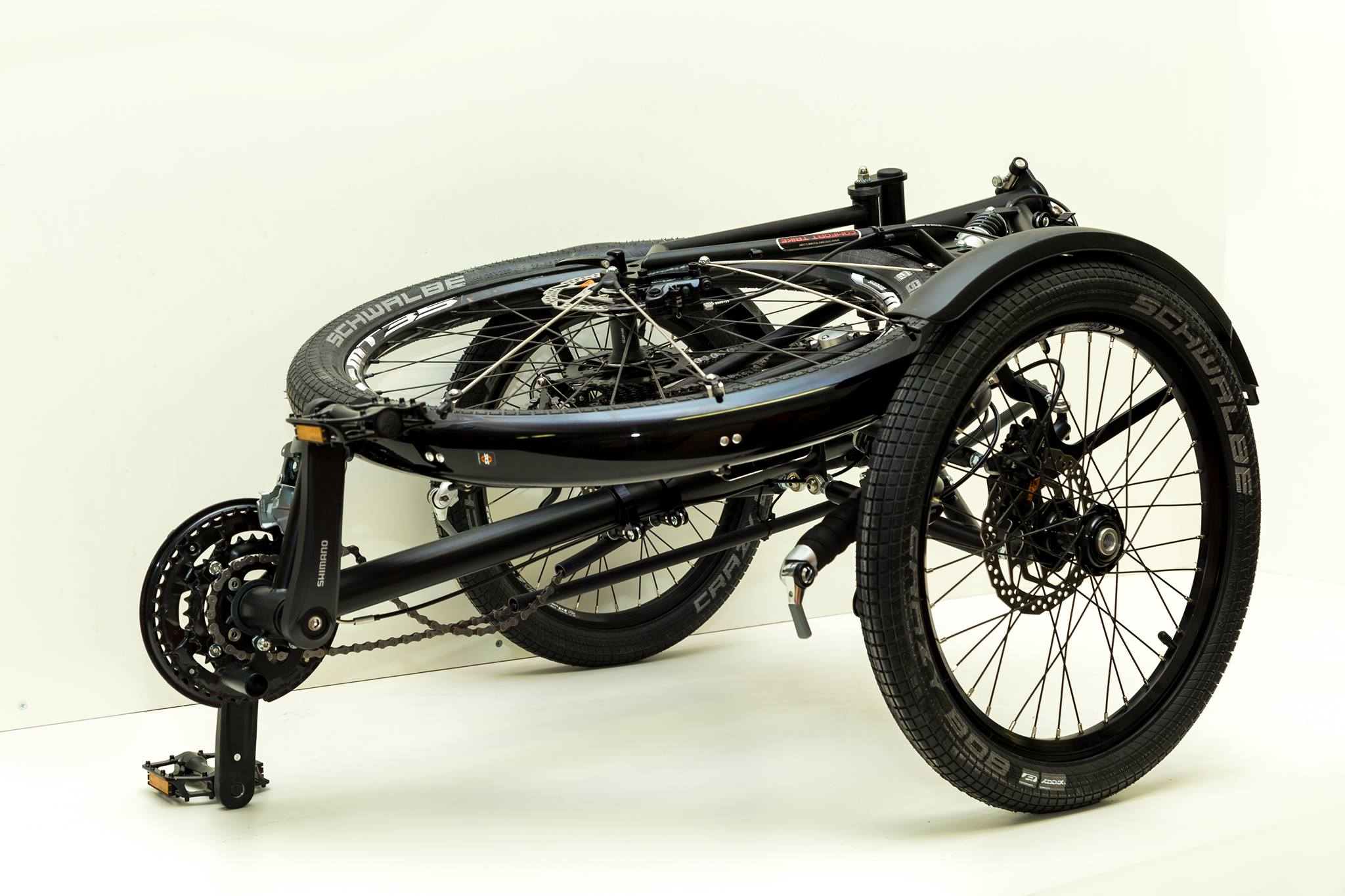

Is there a folding mechanism option? There are some photos in various webpages that suggest at least a prototype of a folding mechanism exists.
What brake, gear etc. options can you offer installed from the factory? Of course you can order a frame kit or a basic model and then switch components yourself, but not everyone is interested in tinkering.
Specbike
Viestit: 113
Liittynyt: 18 Elo 2017, 14:26
Re: SPECBIKE TECHICS nojapyörä
Viesti Kirjoittaja Specbike »
folding mechanism - yes, this is possible

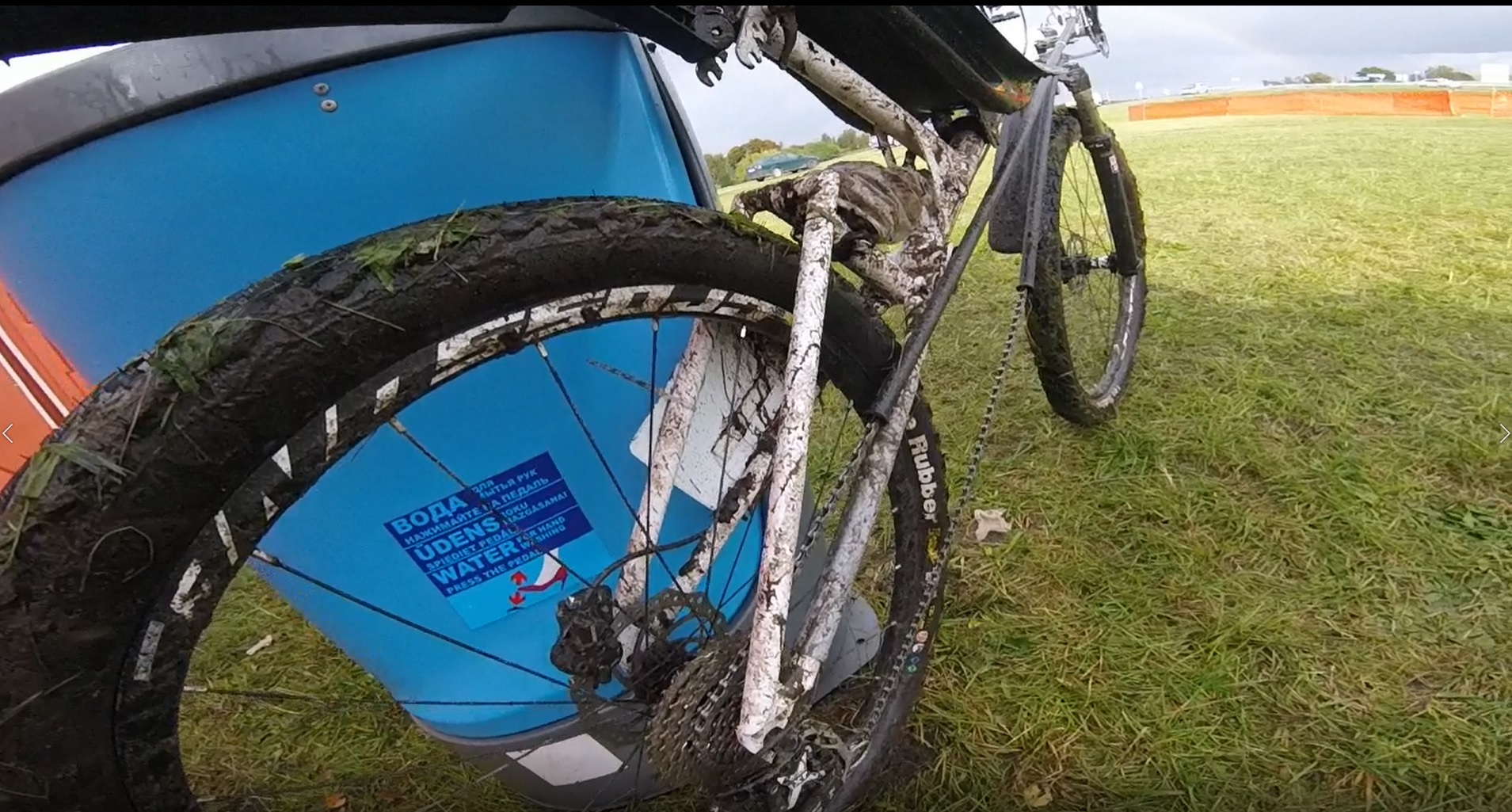

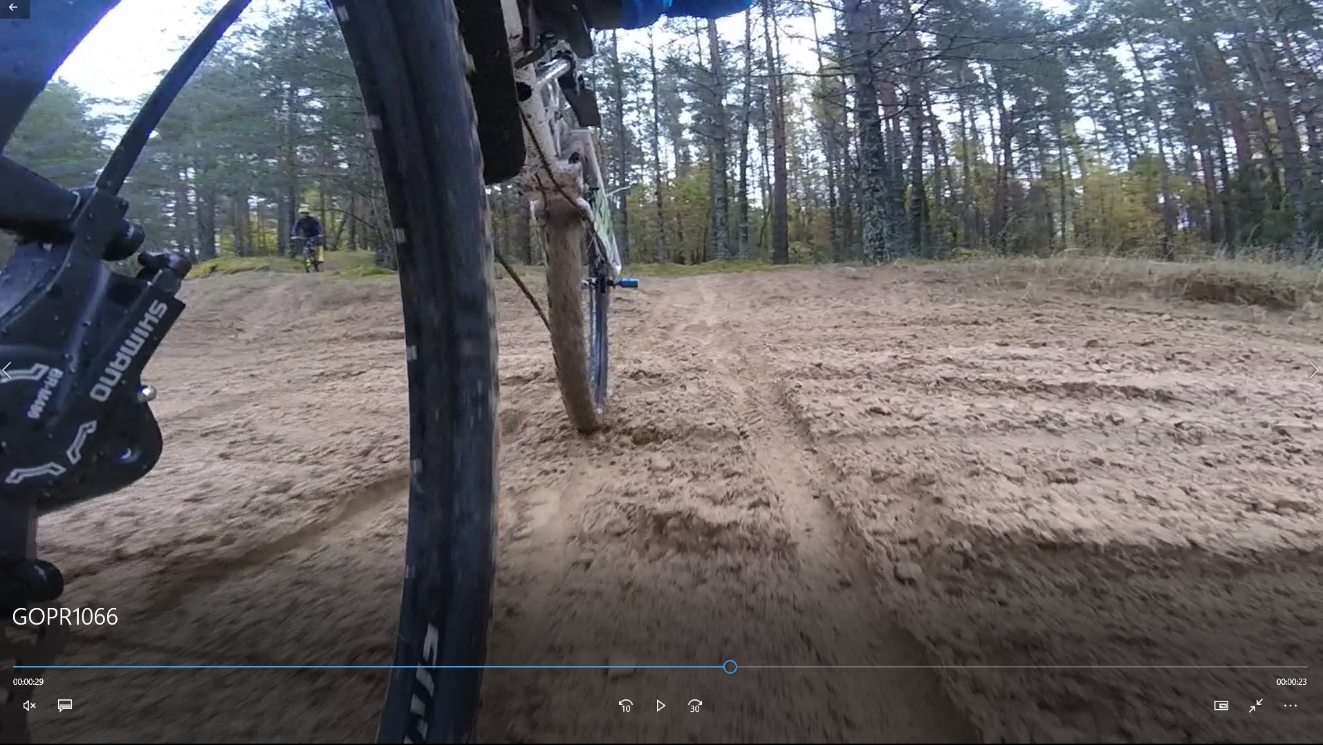

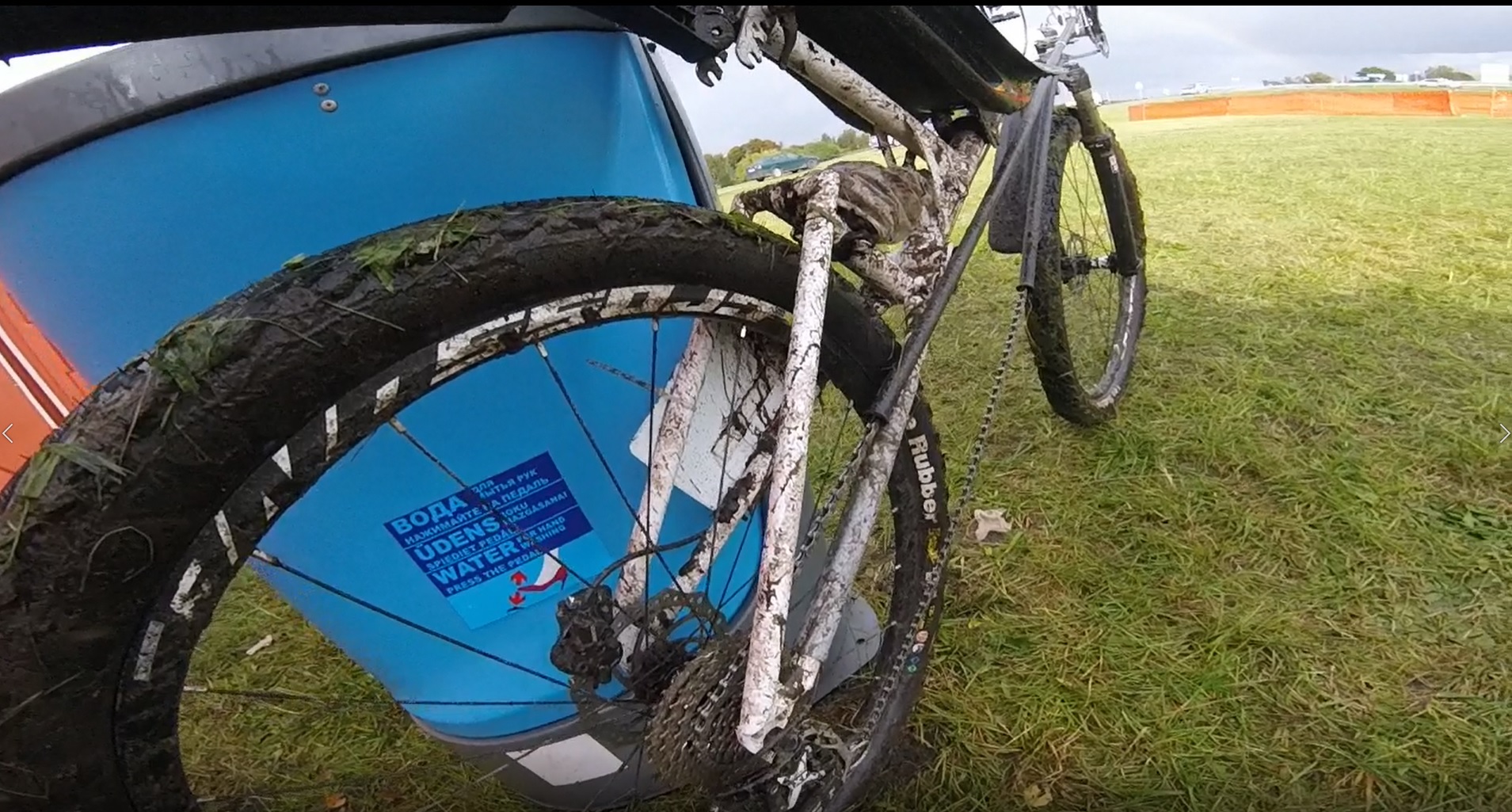

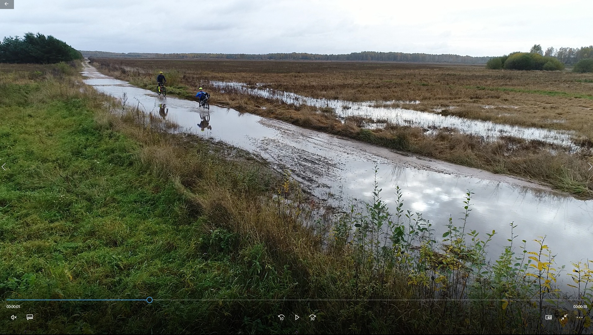

Today I made a special test for a bike on deep mud, the video will be later.
Specbike
Viestit: 113
now on video
