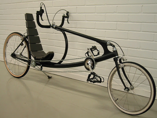

Hi
In case of Zox/Jive clone style, I suggest shortening the main frame so seat and front wheel are closer. Then, a longer vertical part is required in the frame, like my design. So less slope under seat frame as you mean.
But if you build something like Vilijami presents, longer frame is ok. Then remote or under seat steering in needed.
Note 1, Fork does not must to be straight in FWD, but fork with rake guide roll must be positioned more backwards, that chain forces are compensated.
Note 2, Whatever fork you use, check trail value: http://yojimg.net/bike/web_tools/trailcalc.php
Ed. Add clarification.-jarcco

Jarcco kirjoitti:
Hi
The PDQ in the background is a SWB , SWB can give a lively twitchy ride.
I was hoping the Jive having a longer WB would be a bit more relaxing to ride ?
Which bike is that ?
I hoped if the fork was straight it would be easier to get the chain parallel to the fork legs ,and easier to measure the head tube angle ?
My Jive plans shows 67mm trail , is that what you have used ?
So many bikes to cut up and so little time .......

paul_n kirjoitti:
Jarcco kirjoitti:
Hi
That is not always true. Minor changes to geometry can give a great effect. PDQ looks shorter side SWB.
Avoid heel and wheel interference, cranks must be near steering axis, or much front of it.
paul_n kirjoitti:
Jarcco kirjoitti:
Vilijamis trike is at previous page: http://www.nojapyorafoorumi.fi/viewtopic.php?f=3&t=5113
You might be interested also: http://www.nojapyorafoorumi.fi/viewtopic.php?f=3&t=3552
http://tilting.org.za/bok/pedelec.html
paul_n kirjoitti:
Jarcco kirjoitti:
You are right, it makes things easier.
paul_n kirjoitti:
Jarcco kirjoitti:
Yes, 1,5 x tyre width works fine many cases. ( Maybe not Fatbikes :))
