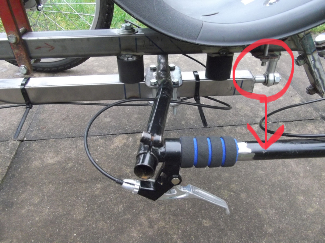

This project has been put on hold for a while , as I sort of the handling of the prototype I made [ the one at the back ]:-
I am struggling to guide it with my feet only and do not feel safe when on a path only 30cm wider than the trike and 60km+ traffic alongside me.
I am getting better at riding it however I seem to have a few ' tilt ' when not needed moments and a couple of why is it going in that direction moments.
I have probably done less than 60km on it so far.
I have 2 elastomers and have increased their stiffness however I have not ridden it very far yet.
What was the reason to get Zero trail for the tilting pivot ?
I wonder whether to try and get the prototype to have Zero tilt trail ?
regards Paul

Negative trail is like a ball in a valley. Good to very slow speed. Hard mass centralize.
Positive trail is like a ball on a top of hill. Good to very high speed, when centrifugal force beats the tilting mass.
Zero trail is neutral, ball on flat. Not react to speed.
Just same think, steering or tilting.
Ok thanks for the explanation , Zero tilt trail equals neutral handling and does not change as speed does.
Looks tricky to implement on the prototype ?
Paul
So many bikes to cut up and so little time .......
Drop the balljoint down as much as need.
Well I have ridden my prototype again to test some changes I made ?
When I first built it I added a second damper to reduce the yaw I was getting from only having one elastomer and the rod end giving 3 axis of rotation ?
So rode with 2 x 84 kg so 168 kg resisting the tilting [ the value is the compression value no one seems to quote bending values ? ]
However I have now upped them to one @ 113 kg and one @ 203 kg so now 316 kg resisting the tilting
An increase of around 45% to it's stiffness.
I find the trike much more restful to ride , stiffer and it feels to accelerate the tilt less when it has started ?
It still swoops and carves the corners as I want so seems just as agile.
However I seem to remember a post on here which started out adding stiffness to the tilt and eventually removing all springs/elastomers so no tilt damping at all ?
What was the reason for that ?
I think apart for a small snagging list I will now just ride the prototype as seat time is very important to master this ? i.e I can safely ride one handed but not no handed [ a useful skill on the Python ] , and resume the Flevotrike I started.
I was puzzled to find I can also tilt & un-tilt with the hips and not as I initially thought moving the shoulders ?
thanks for your input Paul
