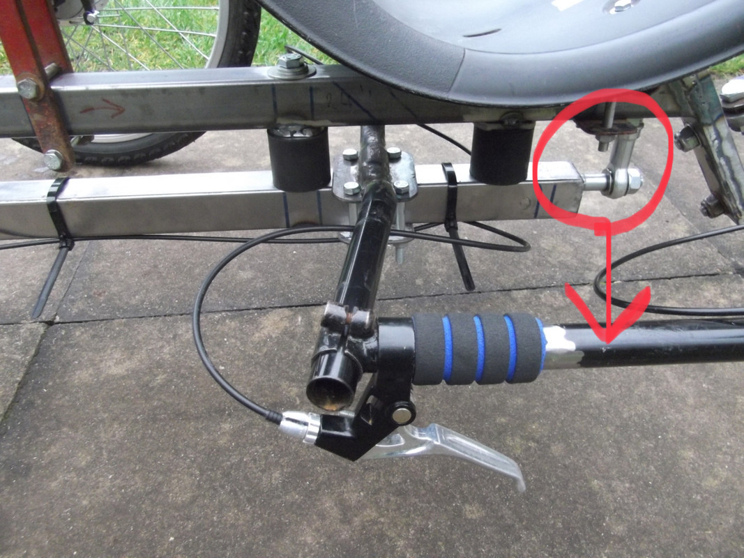

This project has been put on hold for a while , as I sort of the handling of the prototype I made [ the one at the back ]:-
I am struggling to guide it with my feet only and do not feel safe when on a path only 30cm wider than the trike and 60km+ traffic alongside me.
I am getting better at riding it however I seem to have a few ' tilt ' when not needed moments and a couple of why is it going in that direction moments.
I have probably done less than 60km on it so far.
I have 2 elastomers and have increased their stiffness however I have not ridden it very far yet.
What was the reason to get Zero trail for the tilting pivot ?
I wonder whether to try and get the prototype to have Zero tilt trail ?
regards Paul

Well I have ridden my prototype again to test some changes I made ?
When I first built it I added a second damper to reduce the yaw I was getting from only having one elastomer and the rod end giving 3 axis of rotation ?
So rode with 2 x 84 kg so 168 kg resisting the tilting [ the value is the compression value no one seems to quote bending values ? ]
However I have now upped them to one @ 113 kg and one @ 203 kg so now 316 kg resisting the tilting
An increase of around 45% to it's stiffness.
I find the trike much more restful to ride , stiffer and it feels to accelerate the tilt less when it has started ?
It still swoops and carves the corners as I want so seems just as agile.
However I seem to remember a post on here which started out adding stiffness to the tilt and eventually removing all springs/elastomers so no tilt damping at all ?
What was the reason for that ?
I think apart for a small snagging list I will now just ride the prototype as seat time is very important to master this ? i.e I can safely ride one handed but not no handed [ a useful skill on the Python ] , and resume the Flevotrike I started.
I was puzzled to find I can also tilt & un-tilt with the hips and not as I initially thought moving the shoulders ?
thanks for your input Paul
